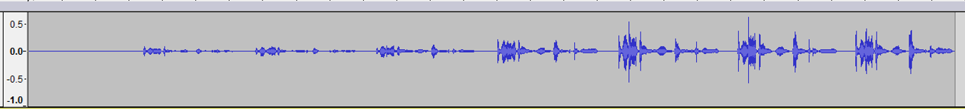

Thanks. I did install the latest version, and moved the USB to a different port just to be sure (it is plugged directly into my computer). I still have the same behavior. The blue lines are definitely shorter in the beginning. Attached is a picture of what it looks like… I kept saying the same phrase over.
You could try a different host in Audacity’s Device Toolbar.
If you have Skype running, shut it down, because it can interfere with recording and playback for other purposes.
Other than that, with the mic as default Windows recording device, try recording in Windows Sound Recorder. If the behaviour is the same, I think you should contact Logitech support.
