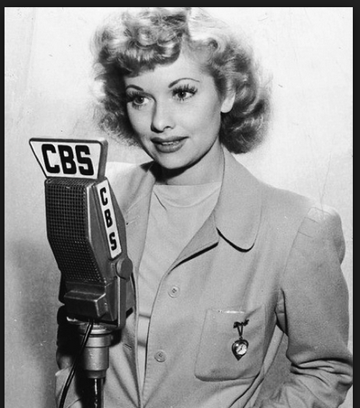

Most microphones respond very differently on and off axis. I’m more than even sure you’re not supposed to be speaking into the end of the CAD U37 Condenser Mic. That’s a side-firing microphone, so you use it like the illustration. That’s an RCA 44BX, a microphone with similar performance requirements.
