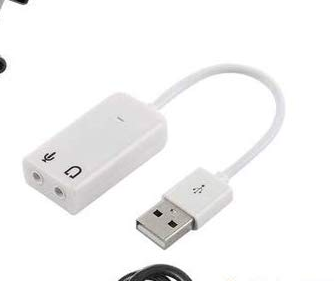

So I actually got a sound card with it and I’ve been able to clear enough of the static in the background so you can hear my voice clearly I just don’t know how to turn up my voice cause in my playback if it’s up all the way I can hear it ok at best. And I’m using Audacity. Any thoughts?

Microphones in this range can be forced to work with the included interface…

…but it’s not the first choice. The voice is likely to be low volume and easily distorted

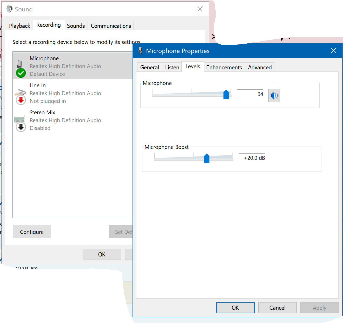

After you announce and record in Audacity, you will very likely need to boost the volume. Effect > Amplify: OK as a start.
That may be a serious restriction right there. The included interface is likely to be noisy and low volume. Reducing noise and boosting volume can create a honky, wine-glass distortion that the audiobook publishers don’t like very much.

You may be able to increase the sound level using the windows advance sound control panel.
