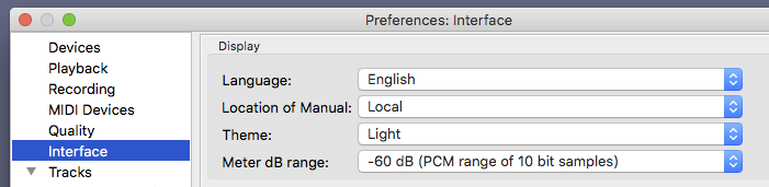

You can totally change the Audacity meter range.
Audacity > Preferences > Interface > Meter Range.
That particular setting will display -60dB (quiet) to 0dB max.
