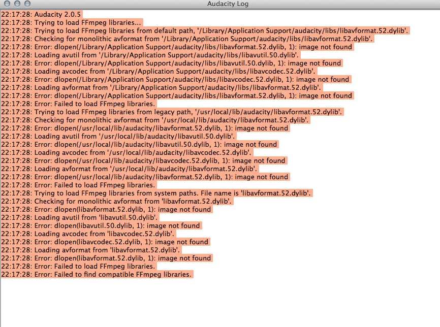

i found this on the " show log "

hello
audacity log snapshot
i solved the FF meg libraries error
but not the image error
thanks for your help

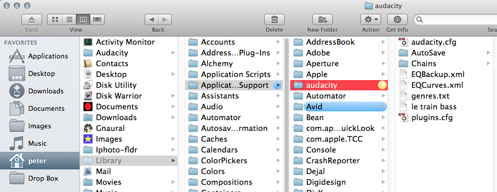

when i click on " audacity cfg " folder
i got the image of another vst instrument witch is on my system and cannot delete the " Audacity cfg " text to write New…
but i can delete the folder " audacity cfg "
what schould i do ?
thanks to let me know
Audacity > Quit Audacity if it is running, then delete the “audacity.cfg” file.
Extract audacity.cfg from the attached zip by downloading the zip then double-clicking on it.
Copy the extracted audacity.cfg then paste it in to Macintosh HD/Users//Library/Application Support/audacity/ so that it replaces the “audacity.cfg” you deleted.

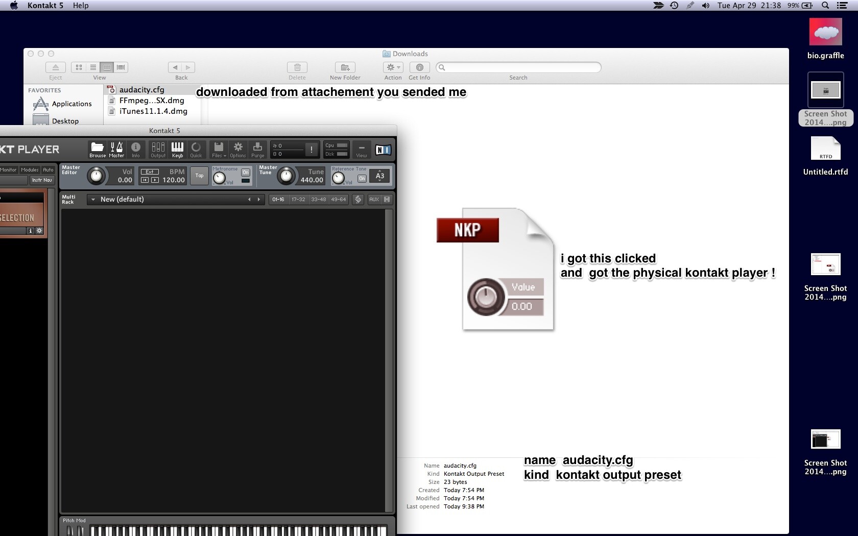

hello
weird look a the attachement , from your download i got NKP plugin and not Adacity.cfg snapshot
in my folder HD > library there is [ see snapshot ]
All you need to do is copy and paste audacity.cfg, not double-click on it.
If you don’t need Kontakt to open files with .CFG extension, you can make TextEdit open .CFG files instead.
To do that, right-click or control-click over audacity.cfg and choose “Open with”, then “Other…”.
In the window that opens, put a tick mark in the “Always Open With” box, select “TextEdit.app” then click “Open”. Now, audacity.cfg and other .CFG files should open with TextEdit and not Kontakt.
If you need to open a .CFG file with Kontakt, you can still do so by right-click or control-click over the file then choose Kontakt from the list.
