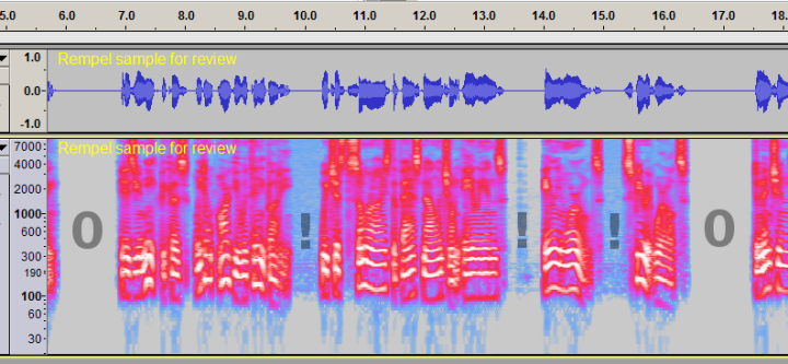

Thanks to the above instructions, I was able to normalize the audio to the ACX requirements.
Now I would like to invite the help of experts to listen to my sample and tell me if the audio quality is good for audible?
https://drive.google.com/open?id=1OO77DU6ZBk6y1UkmYDGWAW1zBG9k2BEy
The mic is Blue Yeti.
And is this a good place to ask such a question? If you know better places, please tell me.
Thanks.
Looks/sounds like you’ve used a noise-gate, but the reaction-time is too slow it’s leaving some of the noise …
If you must use a gate, it should be consistent, and not leave bits behind.
A gate with ~100ms (~0.1s) attack/decay it will remove the remaining bits of noise.
[Attenuating the noise with the gate, rather than removing it completely would be preferable : the bits of total silence are jarring ].

The submission passes ACX, but they have a preference for mono over stereo.
Drop-down menu on the left > Split Stereo to Mono.
Delete one track.
They have a failure called Overprocessing. They might not like the “Blackness of Space” silences between words, particularly if you used the noise gate wrong.
