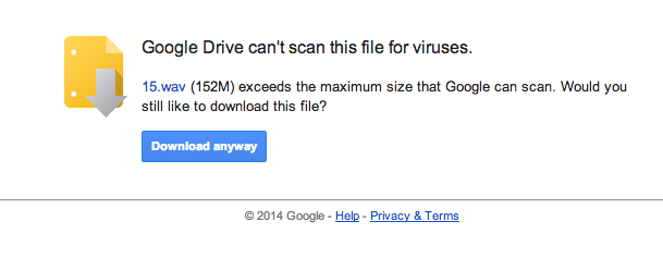

Where’s the Room Tone? You may not need to send it to the client, but it’s required for our processing.
Nope. Can’t proceed without Room Tone. I tried making room tone from the verbal gaps, but there’s too much gasping and breathing to work.

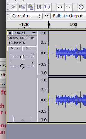

Take 1 still has two sound tracks, “Stereo”. Attached. The download file size is actually slightly larger than the original instead of being half the size. I’m going to go with this and make the mono myself.
When you get to an Export you like, make sure the file sizes are rational. These stereo shows are all in the 155 MB to 160 MB range. A mono version of the same show should be about half that.

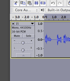

The goal is one of these. Attached.
Another trick is opening up the file in Audacity just before you send it and make sure it’s what you intended.
