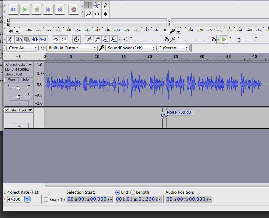

This is what Audiobook Noise Floor did when I ran it (attached). What’s supposed to happen?

Analyze > Audiobook Noise Floor and Effect > Equalization > LF Rolloff for Speech are custom designed tools and have to be hand-installed in Audacity.
