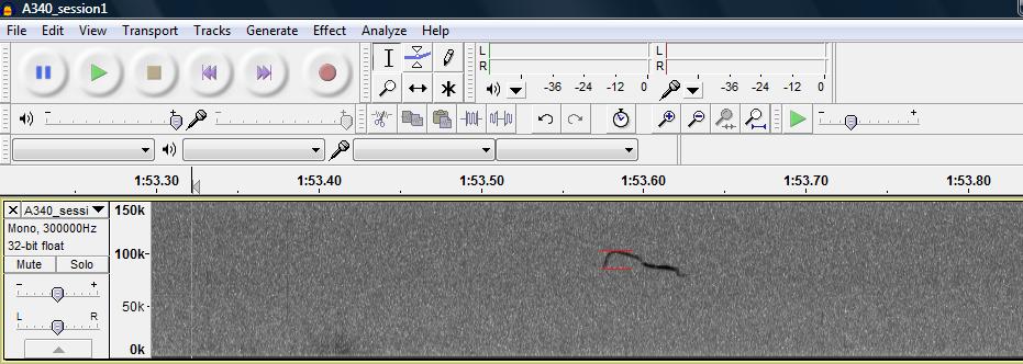

Hi all,
I was wondering if there was a way to measure the exact frequency value at a given point of a signal/recording in Audacity. I wanted to specifically find the frequency range of a signal between 2 time points (the height between the 2 red lines in attached image).
Thank you very much! (:
Hover over the vertical scale at about the same height as the upper red line then drag down as far as the lower red line. Release the mouse then you should be zoomed into that vertical area and you can read the frequency values more accurately.
We quite often get asked for a cursor read out of frequency when you hover over the track or the scale when in a Spectrograms view. We don’t have that feature though.
