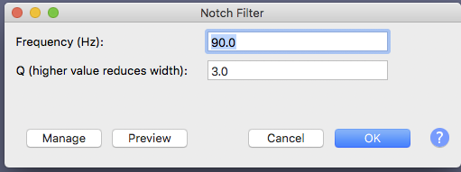

There is a very low pitch single tone riding through the file. 90Hz, if you’re counting. 90Hz is not typical of heating, ventilation, or lighting in either Europe or the US, so I’m going with computer fan noise. Computer fan noise can come and go depending on how the computer “feels,” so that can account for sometimes problems.
I did some pre-conditioning. 90Hz is not valuable sound, so I designed a notch filter to nuke it ahead of mastering.
Effect > Notch Filter: 90Hz, Q=3.
That tone changes the shape of your blue waves and that screws up the tips and peaks. That’s pretty unusual, but I guess you’re just lucky that way.
See if that helps.

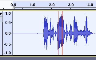

Are you worried about blue waves that get so big they go off the screen and sometimes turn red with RMS Normalization?
Don’t be. That’s normal with the Mastering process. Audacity’s internal sound format doesn’t overload and distort when the waves get too big. Gentle Limiter brings everything back down to normal. That’s why you need to apply all three mastering tools in order and don’t mess with them.

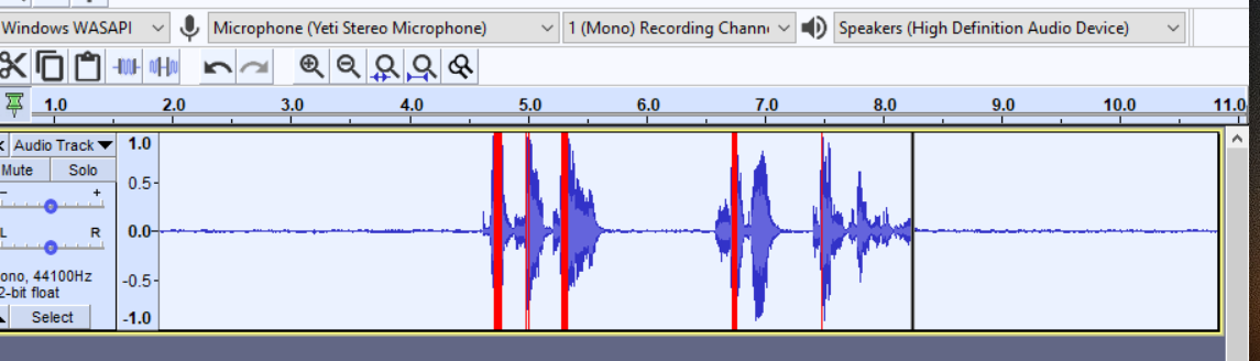

Step 1: Did a recording (and I’ve attached the raw recording below for your review):
Step 2: I did the mastering beginning with the Notch effect, followed by bass/treble … filter curve … and then RMS Normalize … and as you can see from the attachment below, it didn’t work. Altho the base line is perhaps not as thick, it nevertheless is there and precludes doing the rest of the mastering (Limiter and Noise Reduction)
FYI, I brought over another Blue Yeti thinking perhaps the problem was in the mic, but no luck … both mics are picking up some sound. I’ve made sure the furnace and the pool pump were off and no lawn mowers were running outside. Then I also moved the mic away from the computer (about the length of the cord) thinking that may ID the problem, but same result.
I even turned the Gain control almost to the off position with no significant change … the base line is thinner but it’s still there.
I’ve also tested recording in MME and Wasapi with no discernible difference … which leads me to the question as WHICH of these SHOULD I be using whenever we get this thing under control.

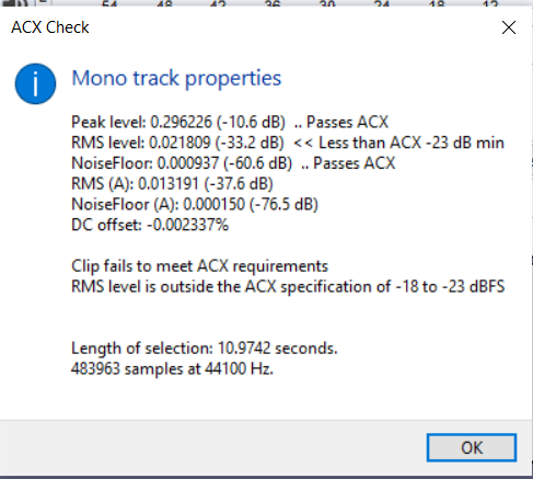

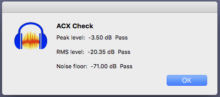

After applying “Low roll-off for speech”, then Bass and Treble (Bass=+6, Treble=+4, Volume=-3), then Amplify (default settings), ACX check says:
Peak leave: 0.0 (fail)
RMS: -19.34 (pass)
Noise Floor: -50.41 (fail)
I’ll ignore the noise floor for now and focus on the levels.
I then applied Audacity’s Limiter.
Type: Soft limit
Input left: 0.0
Input right: 0.0
Limit to: -3.2
Hold: 10
Make-up gain: No

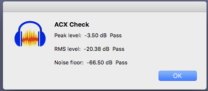

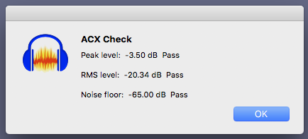

ACX Check now gives:
Bottom Line:
I’d suggest that you get closer to the mic. but avoid speaking more quietly when you do (there’s a psychological tendency to whisper when the mic is very close, so imagine you are talking to someone that is “socially distanced” )
