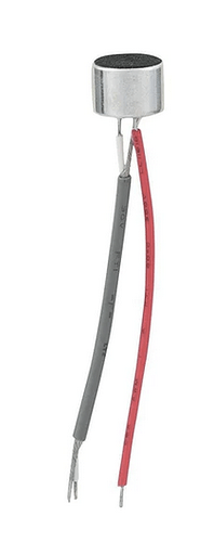

It’s almost guaranteed that’s what’s inside your lavalier. It’s tiny and works well. This one was $4.99, retail.
Post back how it goes. Also, you didn’t tell what your theatrical microphone was.
