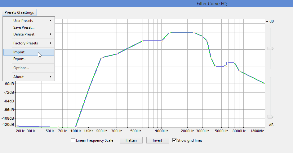

before-after “phoneee” EQ & soft limiter
phoneee.txt (664 Bytes) preset to import into filter curve.
After applying “phoneee” EQ then apply soft limiter.

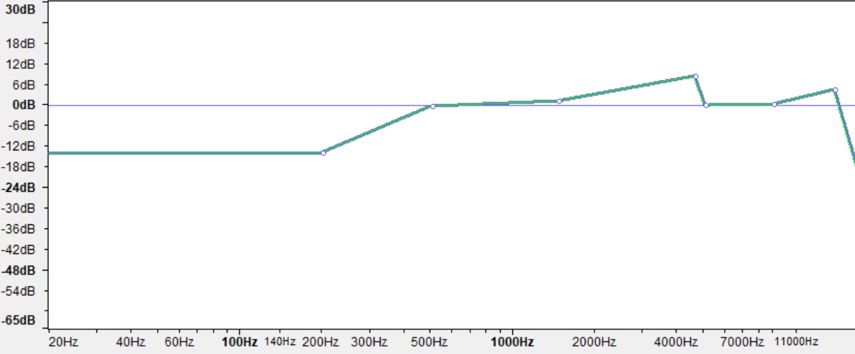

This is perfect, big, big thanks! I had weird curve like this:
now I can see what I didn’t get right, had a feeling that I had to cut low and high frequencies but didn’t figure out how to get the rest of the stuff. Again, thank you!
