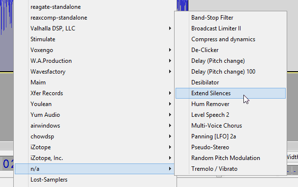

Then restart Audacity, the “Extend Silences” plugin then appears in the “n/a” folder …
Thank you so much. I had found the ny file and managed to run it once from the nyquist prompt, but this clarifies it and makes it workable.
