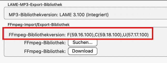

So if I select the corresponding settings, I get this dialog, telling me which ffmpeg version is installed:
When I then click on “Locate” (Suchen), I get this dialog which ask me whether I want to search for a different version:

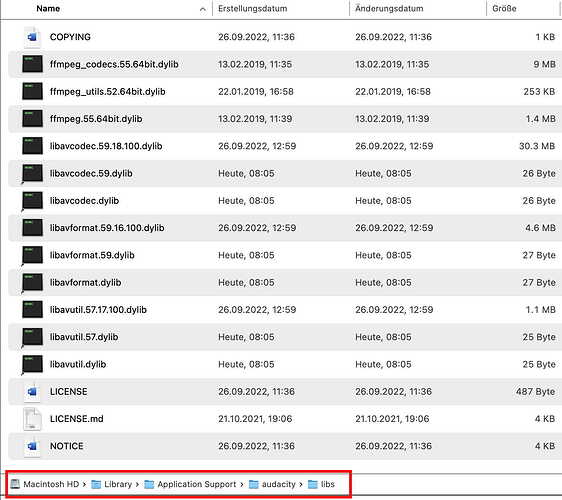

You can see where it is installed in the window below:
