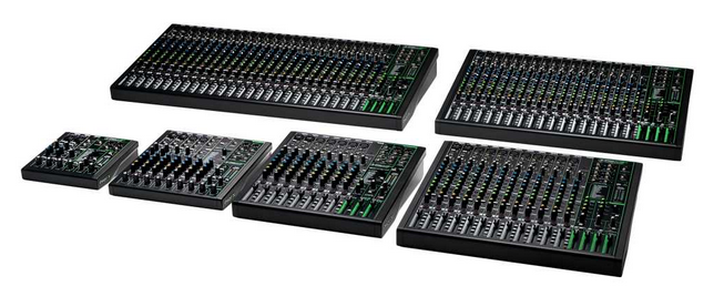

MackieProFX10v3.
That gets it down to six mixers Which one do you have?
Second smallest. Front row, second from left.
