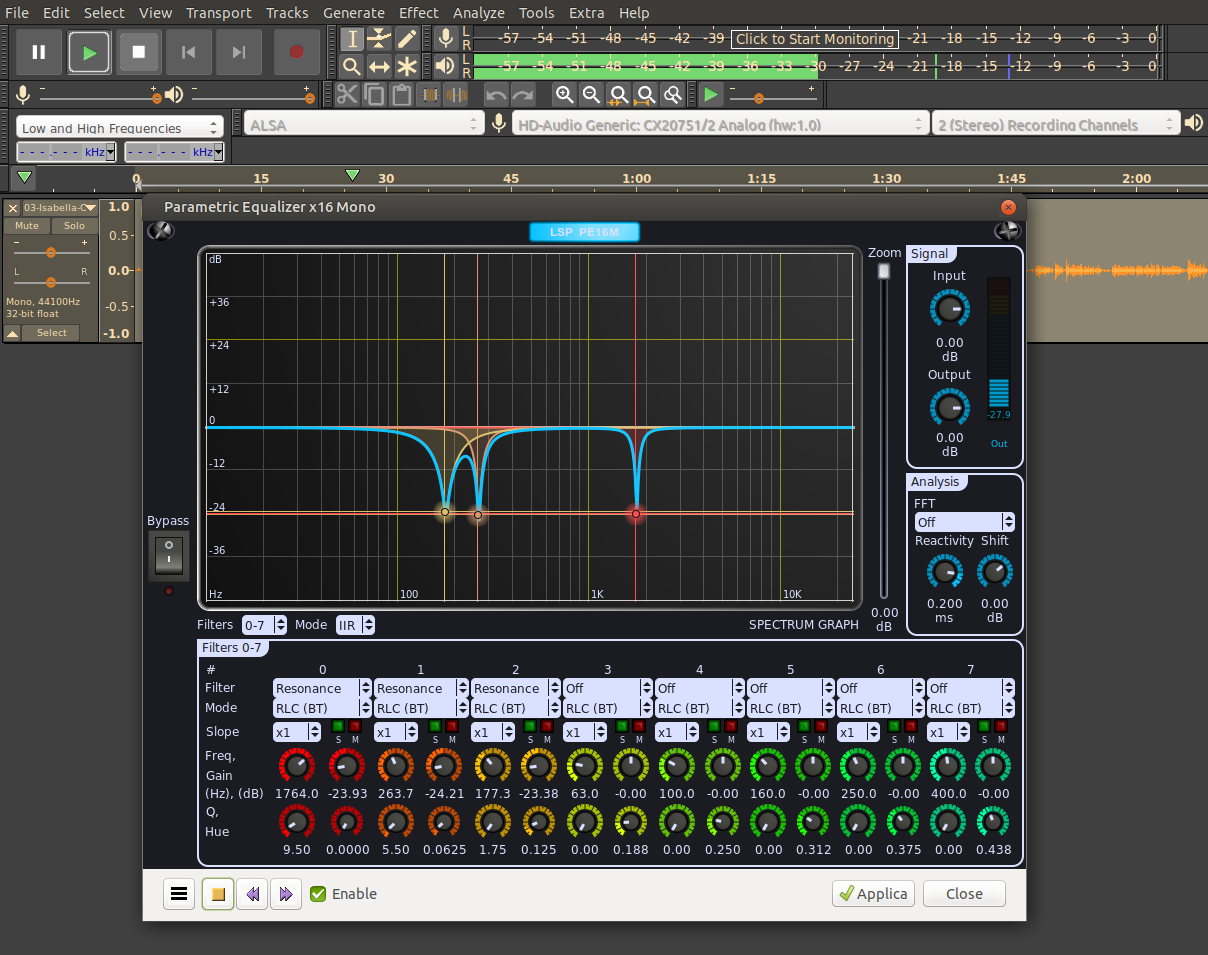

I tried the VST version of the LSP: I can enable them, show them but not apply the effect (only via macro workaround).
Figure/Attachment: Parametric EQ (VST version), Apply button does nothing.

I can’t see in that screenshot - do you have some audio selected?
Yes, the audio is selected. The effect works but when you click on Apply (“Applica” in my system) there is no response.
So I need to create a macro with that effect and then apply the macro to the selected audio… :neutral_face:
It’s hard work :smiley:
