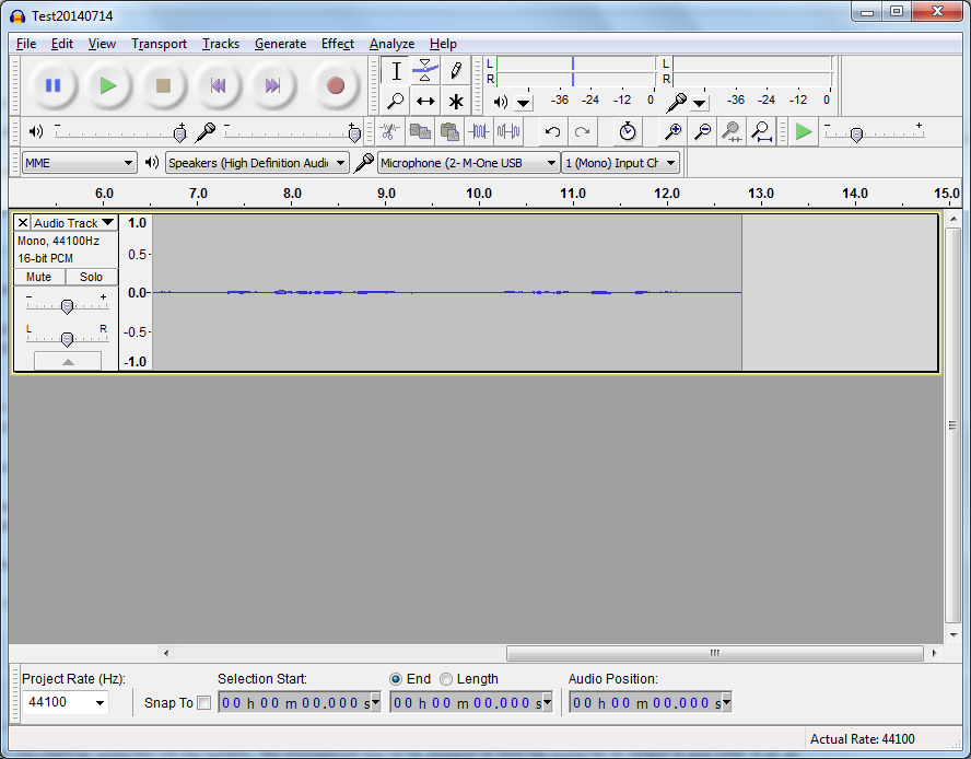

So, what’s happening is that I will create a recording, and be more then close enough (less then 10 inches) to the mic for it to pick up anything that I am saying. It seems like it isn’t picking up with any sort of volume… To listen to the recording i need to have my speakers up all the way to hear anything… I have the input slider to the max, and in the audio settings on my computer I also have them set to the max.
I have attached a recording in two formats.

I’m betting the sound was very low well before you played it back. When you record in Audacity, both the blue waves and the red recording meter should move like this:

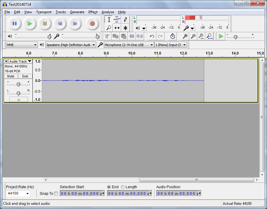

This is my print screen, 20140715.png & 20140715(2) #2 shows the monitoring levels of the mic. I am for sure speaking into the correct mic, and it is picking up the correct mic.
I did some test recording changing the microphone slider from 25% to 100% and there seems to be no difference in the files.

The closeness to the mic doesn’t seem to change to much, i can me practically touching the mic as i speak, and there is still very little in the blue bars for sound.
Even when i go into the set up microphone in Windows it barely picks up the sound from the mic… It says i am not talking and wont let me click through the wizard…

I’m still inclined to think that it just a setting problem in Windows.
Have you looked in the Windows Sound Control Panel?
Try setting the M-One as the default recording device (recording tab), then “Properties > Levels” to ensure that the level is turned up. It should be set for “mono”. Also, look to see if there is a “boost” setting for it.
