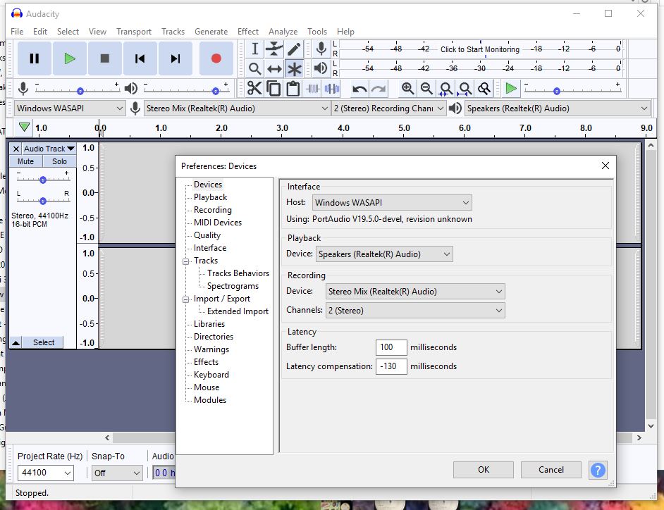

Here’s how I have it set as I was instructed to do in several Audacity Setup Videos, I viewed after I first downloaded it to this new computer.
Windows WASAPI
Stereo Mix (Realtek (R) Audio)
2 (Stereo) Recording Channel
Speakers (Realtek (R) Audio) <<<<<<<<this is the only setting available here
I’ve also attached a snipe of my Preference Devices under Edit, showing the first page.

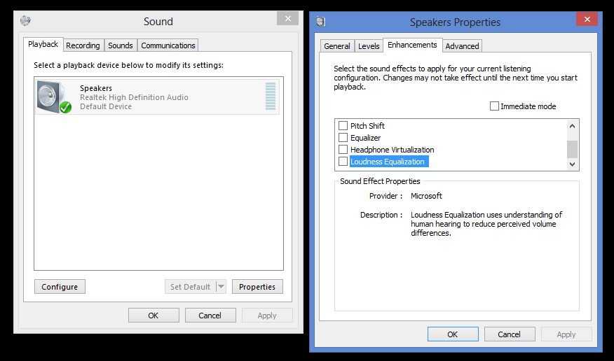

If you are recording Stereo Mix, the “driver utilities” (equalization, surround effects, etc.) and similar Windows audio enhancements may alter the sound in a “good” or “bad” way.
If you’re recording speakers you need to turn off any Windows playback enhancements,
such as “Loudness equalization” …

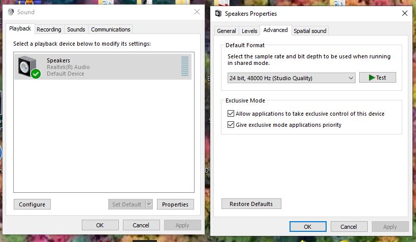

Here’s my speaker setting…with the properties opened.
You’ll see that there is no “Speakers Enhancement” tab available.
If you see something else that I might consider? Let me know.
I’m wondering if the sample rate (as shown) should be adjusted?
(I would think not, if this is the default computer setting)
