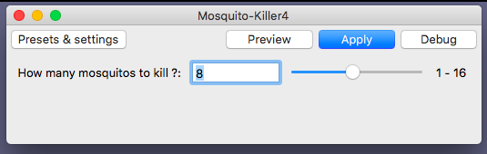

I don’t think we actually got the poster to confirm that my sample is the noise he has. Frying Mosquitoes. In a blast from the past, we do have a Frying Mosquitoes pre-built filter.
I can’t believe I remembered where it was…
Mosquito-Killer4.ny (363 Bytes)
So you may not need to rip your system apart and fix the whine crosstalk.

OK, so that’s probably not it. Did we get posts out of order? Two messages up I posted a tool we designed to get rid of USB whine errors like that. Depending on how successful that is, you may not need to fix anything, although the system is broken.
Mosquito-Killer carefully removes all or most (it’s a setting) of the musical tones that make up that whine. It can do this because USB service data is pretty much standard. The default (8 mosquitoes) usually does it, but be clear it is removing some tones from the performance.
Screen Shot 2024-08-14 at 10.46.39
Post back how it goes.
I came up with the screaming mosquitoes name. We couldn’t think of a good name, either. And we are assuming that’s what it is. If it’s not, Mosquito Killer won’t do anything.
