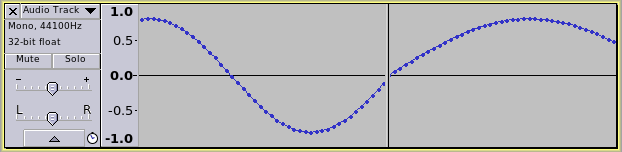

There are several possibilities:
  1. Change in frequency content:
    In this example, there is a sudden change to a higher frequency. Notice the kink in the waveform at the join - that will produce a slight click.
    To avoid clicks you need a smooth transition.
  2. Change in amplitude:
    In this example, there is a sudden change in the waveform amplitude. Again, notice the kink in the waveform at the join.
    To avid clicks you need a smooth transition.

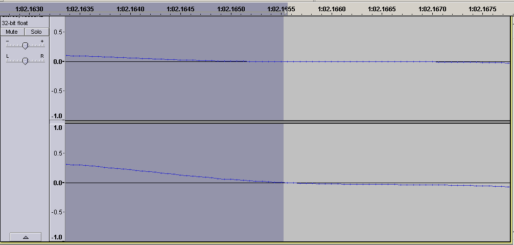

here is a screenshot showing the cut point:
