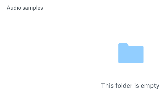

I’m using 2.2.0 Did you want me to cut those down to 20 seconds then post directly to the forum then instead of the longer pieces in my dropbox?
Here’s a short clip of the raw recording. I would love to know exactly what you would do in post to get the best sound so i can compare notes to what I have been doing. Thanks.
There is no longer pieces. The dropbox folder is empty.
