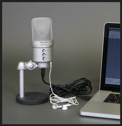

I expect the end client to not be hearing my voice in real time since it’s going out across the Internet which isn’t a problem, but what I wasn’t anticipating was hearing my own voice twice. For example, I say a word in real time and then I hear it a half second later in my headphones. Thanks again for your input.
Turn off “Playthrough.”

I’m too far from the router. If I turn off play thru zoom doesn’t pickup the audio
Zoom doesn’t pick up my voice in my mic until I hit the record button in Audacity
So you’re sending Audacity Playthrough to the far side through Zoom. That’s always going to be “one computer late.” Your voice has to go through recording processing and then turn around and go through playback processing.
That’s why in overdubbing, you have to listen to the microphone, MicPre, or interface, not the computer.

There shouldn’t be any need for your Zoom director to hear from Audacity except when you’re playing back a previously recorded take.
This is the sort of thing I’d try. This assumes you have an audio interface and it’s selectable in Audio Midi Settings.
Set up an aggregate device in Audio Midi settings to include your interface and blackhole (checking the box beside blackhole marked Drift Correction). Name the device e.g. Zoom Live VO Input.
Set-up a multi-output device, including blackhole (drift correction checked) and whatever you’re monitoring with - hopefully headphones, so choose External Headphones if they’re plugged into the mac, or your interface if they’re plugged in there (preferable). Name it VO Playback.
In Audacity, select your interface as input as normal, and your new VO Playback device as output (with Software Playthrough of Input unchecked).
In Zoom, select the Zoom Live VO device as input and your interface/external headphones as output.
This way, Zoom should hear you live without (noticeable) lag and hopefully both you and Zoom partner will hear playback from Audacity when you playback a take.
I think that’s the general shape of things but have very possibly missed out a thing or two.
That’s required. If you don’t do that, Zoom is going to do echo cancellation, environment suppression and noise reduction. It’s not pretty.
Good point. We don’t know what the microphone is, do we? That might be good to know.
