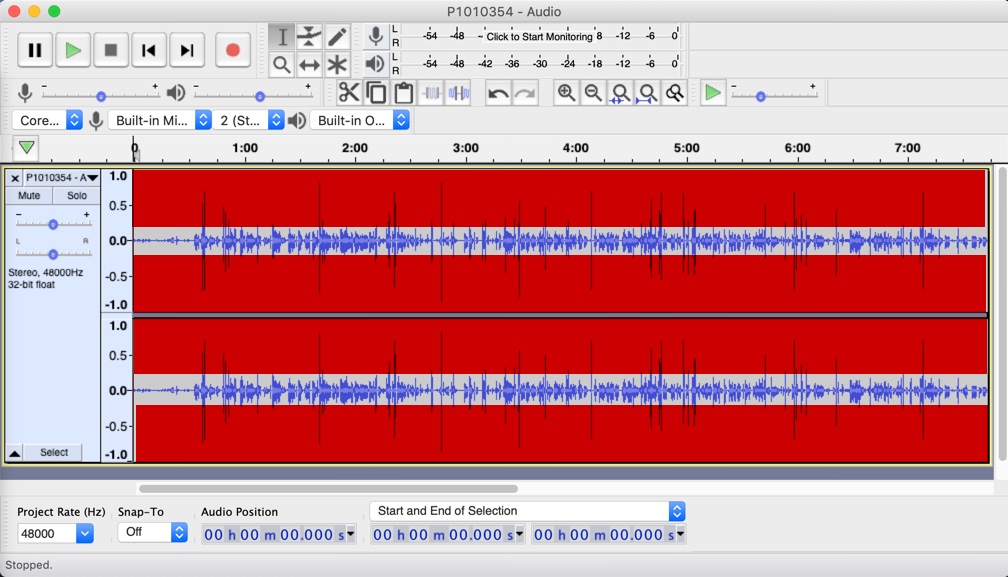

Consider this image:
(I added the red color.) I want everything marked in red to have it’s volume dropped so it’s not in the red, so to speak. I want all the rest of the audio to remain completely untouched (as much as possible, anyway).
And I don’t have to do it using the mouse - I’m OK with entering numbers in a dialog or whatever. In fact, I’d prefer to do it that way, because it’s easier to automate.
What’s the best way to do this? I’ve tried using the Limiter effect, but it seems to me it affects the surrounding audio also, but maybe I’m not using it right? Or maybe it’s my imagination?
Anyway, any help will be appreciated. Thanks!
Soft Limiter can be used to tame peaks without being audible and without affecting the sound on either side.
It can be used inside of a Macro.
I use it to limit voice peaks to -3.5dB. If you use it stronger you may be able to hear it working.

The “Soft Limit” setting in the Limiter effect has an effect on all audio that is “close” to the “Limit to (dB)” level. The closer the audio is to the “limit to” threshold, the stronger the effect is. This is intentional as it smooths the transition between parts that are limited and parts that are not, making the effect sound more natural.
The “Hard Limit” setting is similar, but has much less effect below the threshold.
The “Hard Clipping” setting has no effect below the threshold, but the transition is so abrupt that it causes very noticeable distortion (it literally cuts off the peaks).
For your application, the “Hard Limit” setting may work best.

I have this exact problem but with music. I have songs with only a few high peaks in the entire song. I want to “cut” those peaks to a set threshold without it causing a square tabletop like wave but also without it touching anything below that set threshold. Everything i try affects the entire song in audacity.
That implies that you are setting the limiter threshold too low. Experiment with different setting until you get what you want.
Audacity’s built-in limiter effect doesn’t touch anything where the level is below the threshold. Unless you use make-up gain… Make-up gain amplifies everything after limiting.
And if you run the limiter twice (with no make-up gain) nothing happens the 2nd time.
…And there is a “Hold Time” so the level is reduced for a short period of time after the limiting.
