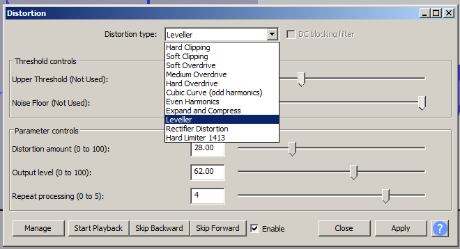

In 2.1.0 there was a plug-in called Leveler. It worked fairly well for what I need. It does not appear in 2.2 or 2.3. Where can I find that particular plug-in and install it in 2.3?
There is a a native Audacity effect called limiter which can do the same thing, but without distortion.
If you want a leveller which distorts the sound, that’s available in Audacity’s distortion effects …
https://manual.audacityteam.org/man/distortion.html
And yes it always did that. Leveller was kept around after the effects shuffle because it’s a terrific way to create the Taxi Cab and Air Traffic Controller distortion by multiple pass applications at high settings.
