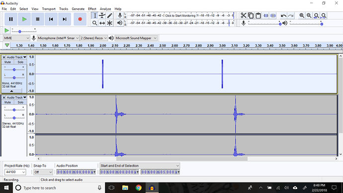

I am generally looking to have multiple tracks simultaneously playing, so I guess the overdubbing latency is the one i have trouble with. My first track sounds good. But when I try to add melody on another track it goes 1.24 - 2 milliseconds after. How can I fix this?
This is what my screen looks like when I add a rhythm track and record it. As can be seen it is around 1.4 milliseconds late.
It looks to be considerably more than 1.4 ms. More like 120 ms (1 ms = 0.001 s, 100 ms = 0.1 s).
The instructions for correcting this in Audacity 2.2.2 (the current version of Audacity) are here: http://manual.audacityteam.org/man/latency_test.html
My guess, based on that picture, is that you will need to reduce the “Track shift after record box” setting by about 120. So if the setting is currently -130, (minus 130), then try reducing it to -250 (minus 250).
