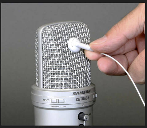

The goal is to have the backing track, your live voice, and the voice recording to “appear” in perfect time with each other. You can’t actually do that because of computer delays, so Audacity fudges things a little. For example, play the backing track to the performer “slightly early,” so the end result comes out right. There’s a couple of different ways to do that and I don’t remember which one Audacity uses, but you have to test the computer to find out how sloppy it is.
That’s the ‘jam the headphone against the microphone’ thing.

The time difference between the backing track and the fresh, new recording is the correction to be applied to the Latency setting. You are required by the laws of the State of California to go the wrong way the first time and make it worse. Then figure out what you did and fix it.

Add the time difference between the backing track and the new recording to the existing negative value.
Whut?
Test it again. If it gets better, you went the right way. Do that more—usually once more to make it perfect. If it’s really screwed up, subtract instead of adding the numbers.
