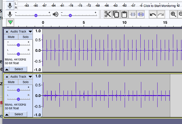

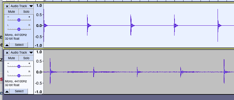

I just did a latency test on this machine. It’s clearly off, but I don’t see any arrows. Did I miss something?

There is another possible failure. You can be ultra cautious and apply a correction that’s too small to see. Add or subtract 100 to what’s there and see what happens.
You understand you’re required by the State of California to go the wrong way the first time and make latency worse? Little known fact. What you’re supposed to do is note the difference between the old and new time line positions and add or subtract it to/from the negative latency value already there.
You sort that out. I’ll wait.
As Steve points out we failed to update the latency test page in the manual when the time-shifting left-arrows were removed. Latency compensation still works as described. But in the second-last illustration there will be no left-arrows and no audio to the left of time zero.
