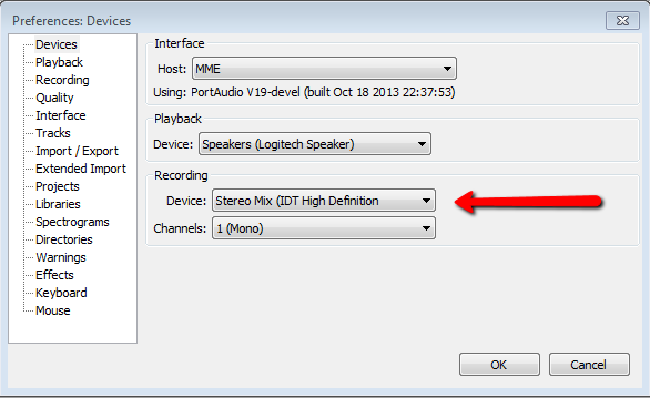

Yes, this is what’s so crazy. It’s on Stereo Mix, but not recording through the stereo mix, but the microphone instead. Here’s a screenshot of the Audacity > Edit > Preferences > Devices > Recording > Device section: http://screencast.com/t/2BkbP9n1

It’s probably correct. Stereo Mix means “whatever the computer is doing.” Now go into Windows Control Panels and find out what Windows is up to. If Windows has your microphone selected, then that’s what the computer is doing.

I would think the reason it doesn’t work is that your playback device is Logitech speakers (is that a USB device?) and the stereo mix is the built-in sound device (IDT). Stereo Mix IDT can only record stereo mix from sounds playing on the IDT built-in sound device.
If you can’t (or don’t want to) use the IDT speakers device, then the “better way” is to choose WASAPI Host (not MME), Logitech Speakers for output, Logitech Speakers (loopback) for input, and set recording channels to stereo.
This is all explained in Tutorial - Recording Computer Playback on Windows - Audacity Manual .
