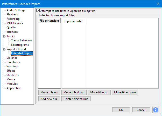

Go to “Edit menu > Preferences > Extended Import”
Does it look like this?
Yes, I don’t know maybe is the file, you can download it here https://audionautix.com/Music/AcousticBlues.mp3
