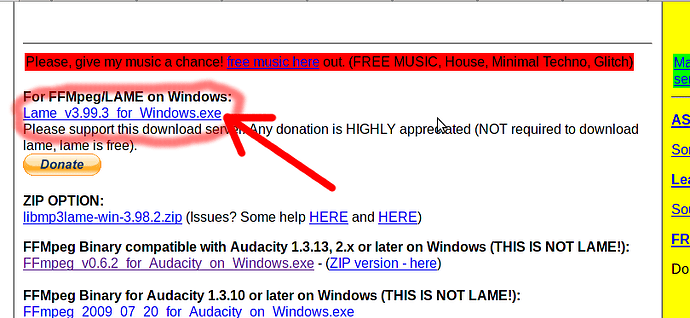

You must be clicking on the wrong link.
This is the download page: http://lame1.buanzo.com.ar/
and the correct download link is a TEXT link that says (in blue writing and underlined):
Lame_v3.99.3_for_Windows.exe
Do not click on any of the graphics and do not click on the banner.

When you are satisfied that you have fully removed “Audio Converter” and that your computer is free of viruses and working correctly, the correct download link is this one
on http://lame1.buanzo.com.ar
