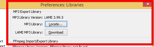

Sourceforge for LAME is showing the latest version is 3.99.5, with a link to a page with compiled binaries for windows (32 and 64 bit). I downloaded these libraries, and pointed Audacity to each in turn using Preferences → Libraries. The “MP3 Library Version” continued to show 3.99.3, regardless of which lame_enc.dll was being used.
Each lame_enc.dll (current 3.99.3, 3.99.5 32bit, 3.99.5 64bit) produced an MP3.
What are the essential differences, as far as Audacity is concerned, between LAME 3.99.3 and LAME 3.99.5?
Why did Preferences → Libraries continue to show the the LAME version as 3.99.3 when using version 3.99.5?

The log showed that Audacity tried to use the lame_enc.dll specified in Preferences → Libraries, got an unknown error, then went back to the LAME as stored in the registry.

Using http://www.rarewares.org/files/mp3/libmp3lame-3.99.5x86.zip and renaming to lame_enc.dll:
11:03:57 PM: Attempting to load LAME from previously defined path
11:03:57 PM: Loading LAME from C:Program Files (x86)Lame Binarieslibmp3lame-3.99.5x86-1lame_enc.dll
11:03:57 PM: Actual LAME path C:Program Files (x86)Lame Binarieslibmp3lame-3.99.5x86-1lame_enc.dll
11:03:57 PM: Error: Couldn’t find symbol ‘beWriteInfoTag’ in a dynamic library (error 127: the specified procedure could not be found.)
11:03:57 PM: Error: Couldn’t find symbol ‘beVersion’ in a dynamic library (error 127: the specified procedure could not be found.)
11:03:57 PM: LAME library successfully loaded
This version will produce an MP3 and shows Preferences → Libraries → MP3 Library Version: LAME 3.99.5.
