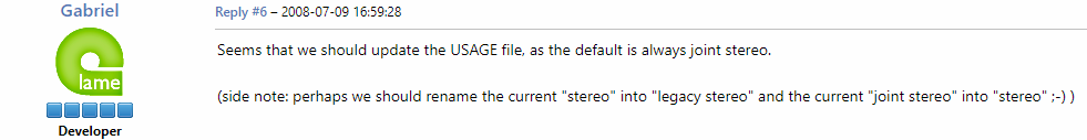

Digging around a bit, I found a forum post of a LAME developer suggesting to rename forced L/R stereo to “legacy stereo”… in 2008!
