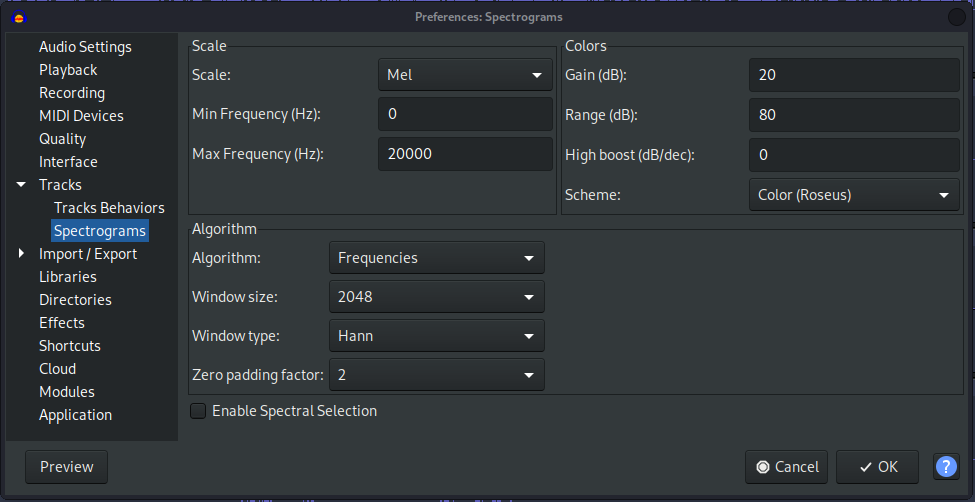

I was having the same issue but then it stopped end I turned off “Enable Spectral Selection”
What ?? Wow. Okay, I’ll go look for that too. Thanks!
