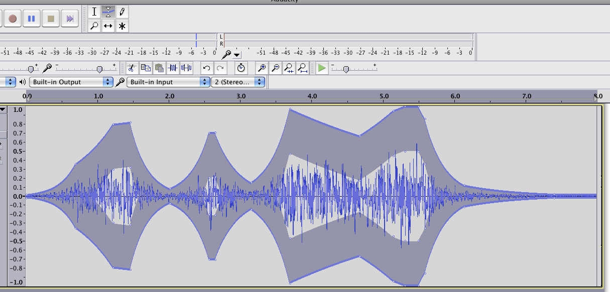

Generate > Noise: brown, 0.8 level, ten seconds.
Effect > Low Pass Filter: 24dB, 150Hz.
Is that the type of sound you’re looking for? That’s earthquake sound. If you can’t hear that “truck going by” sound, then your sound system may not be up to it.
I used the envelope tool (two white arrows and bent blue line) to create this earthquake effect from the above brown noise and filters. The picture is what the timeline looks like.

No, I just get a hissing noise. No truck sound. No rumbling like an earth quake.
I think that Koz meant for you to download the “FourPointOh8Seconds.mp3” attachment in his post and listen to that.
