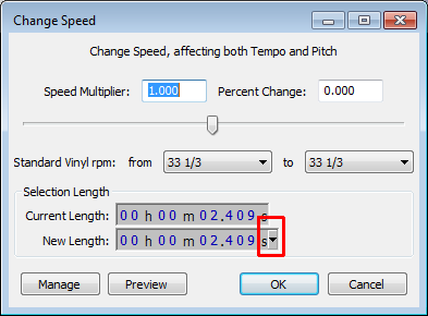

See this image:
If you don’t see the length boxes then you have an old version of Audacity and you should upgrade: Audacity download latest version. We always ask you to say what Audacity version you are using (see the pink panel at the top of the page).
