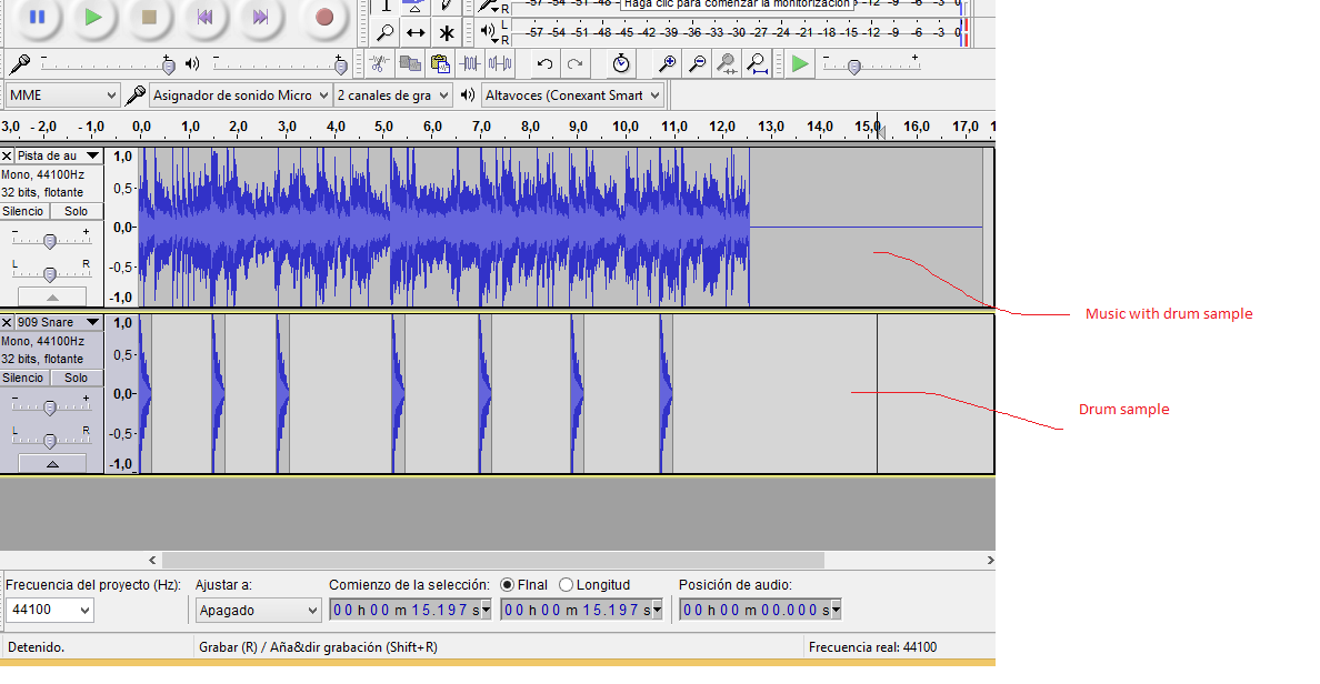

I did not mean stereo tracks recorded in a studio
Look i have
Music with drum sample
Drum sample
Picks up the samples in the areas where the drum sample is heard
I want to use the same sample to subtract the sample of the music
So the music would be without the drum sound
look
Yes that is possible, but for complete removal you need to match the samples exactly with the samples used in the song.
That will make complete removal impossible. MP3 is a “lossy” format, so the MP3 of the “song with drums” will not be an exact copy of the original song with drums mix.
The drum samples need to be lined up exactly with the drum samples in the song, and the amplitude of the drums also needs to match exactly.
When you have them matched exactly, make the two tracks into one stereo track (see: Splitting and Joining Stereo Tracks - Audacity Manual) and then apply the “vocal removal” effect (http://manual.audacityteam.org/man/vocal_remover.html). This effect “cancels out” anything that is common to both left and right channels.
If the drum samples match exactly in both channels (they won’t be exact because the mix is MP3) then you will get complete removal of the tracks.
If they are extremely close but not exact, then you will get some reduction, but not as much.
If they are very close, then there will be a bit of reduction, but not much.
If they are quite close, then that is not close enough and there will be no reduction of drums in the mix - the drums could even be louder.
