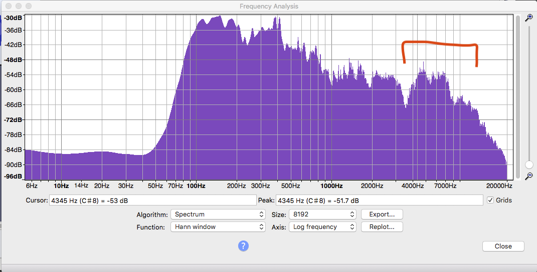

Both pass the technical standards checks, but in my opinion they’re a little too crisp and piercing. “AliSS felt thiSS could not be denied.”
That little haystack between 3500 and roughly 8000 (along the bottom) should not be there. That produces the “ice pick in the ear” sound which microphone makers would like you to think is “professional.” It’s not.
There is a tool for this called DeEsser, but I’m not good at using it. It’s really easy to convert one sound quality problem into a different sound quality problem.

Like dropping a flannel rag over the microphone? Not that I know of. The makers build in the effect in such a way that it’s rough to remove. If you do anything wrong, the voice becomes muffled and dull.
The object is carefully remove the occasional, sharp, gritty SS sounds (classic essing) without affecting anything else. The DeEsser is a bespoke tool. It has to be adjusted for each reader and microphone.
I open a segment of the work with essing and Analyze > Plot Spectrum at that size or greater. You can probably get Timeline Dropdown > Spectrogram to do a similar job.
It’s best to apply the tool after mastering so your voice volume is stable. In general, you don’t have to worry about DeEssing affecting ACX standards because while essing may sound annoying, there’s not a lot of vocal energy (RMS) there to throw things off.
So that leaves threshold and bands. This is where I’m messing with settings to get a feel for what they do. Threshold is pretty simple, the larger the negative number, the more it digs for damage—and the greater the possibility of finding too much work.
I think getting the number of bands wrong can turn SS sounds into FF sounds. Escaping air without the sharp edge. It gives you a speech impediment. There is an odd tradeoff with some settings. You can make it do a perfect job, but it can take a week to complete.

This is me reading a sound test into a Zoom stand-alone voice recorder (not a USB microphone). This sounds like me, there’s no essing, and there’s no haystack on the right.
More importantly, if I wanted to make myself a little brighter, it’s easy done with with Effect > Bass and Treble, Effect > Filter Curve, or Effect > Graphic EQ. No permanent distortions built-in.

The threshold for Paul-L’s de-esser should be close to the RMS of the audio, (+/-2 dB).
(IMO leave the other De-Esser settings as shown).
Paul-L’s de-esser is a multi-band brickwall limiter, rather than multi-band compressor,
so it can sound unnatural when removes a big chunk of loud sibilance: it shaves it off flat.
A workaround is to create an in-sync duplicate track of the original,
and mix that in with the de-essed version, at about-20dB below the de-essed version.
Then the de-essed sibilance then has some variation to it, rather than shaved uniformly flat.
