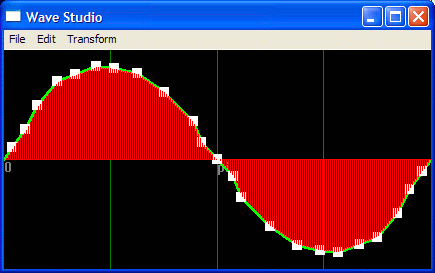

There’s apps for that, e.g. …
Draw waveforms and hear them
