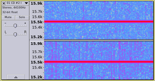

For the purpose of illustration, here is a short section (about 5 seconds) that is alleged to be from an Audiofonix recording from “Holosync”.
As can be seen from the spectrogram, there is a constant 15500 Hz whistle in the recording:
Having tried several test, that whistle does not appear to contain any meaningful information - it’s just a constant tone.
Similarly at the low end of the spectrum is a constant 120 Hz hum:
Again there does not appear to be anything meaningful in that hum - just a constant 120 Hz sine wave, most likely “mains hum” (http://en.wikipedia.org/wiki/Mains_hum)
I’ve also tried manipulating the sound in other ways, but as far as I can tell there is no “message” in the recording.
