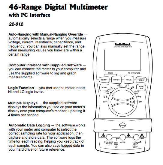

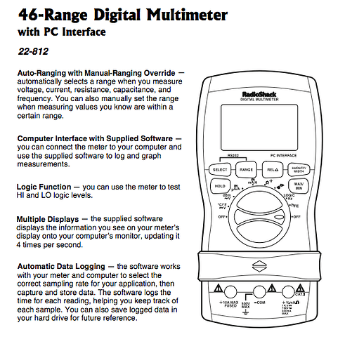

Another solution would be a DMM with serial interface, but I have no idea how good/bad the frequency range is. Usually, it’s something like 0-5 KHz, but YMMV.
My DMM has a serial interface, but there was something about it that caused me to never use it. Even though the instrument has a high frequency rolloff over 1 MHz, the serial data stream was stupid slow, something like a sample per second or something like that.
