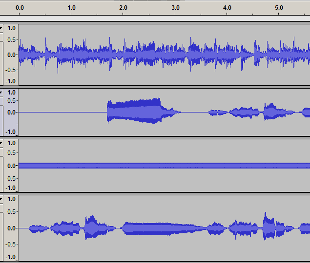

Hello,
i’m working on a multitrack recording. I want to mute the first 2 seconds of all tracks so there is a little silence before the music starts. some of the tracks have a little noise (me adjusting my chair, taking a breath, etc) that I want to mute all of that, for all tracks
the only way I can see to do this is to go into each track and use the envelope tool, one at a time.
is there an easier way?
thanks
gary in vermont
also related, I’m looking for a way to trim all tracks at once?
