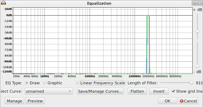

Thanks a lot for your answer ! I recorded a new sample at 20 000 Hz and I successfully isolated the 20 000 Hz frequency. Now I can visualize the sound :
Now, there is a way to visualize the sound like that ?
I’ll second Steve’s suggestion, but don’t make it too narrow. You don’t say what your bit-rate is. Your filter needs to be wide enough to pass the sidebands that result from your modulation of the 20 kHz carrier – roughly 4x the bit rate for the particular modulation scheme you are using.
