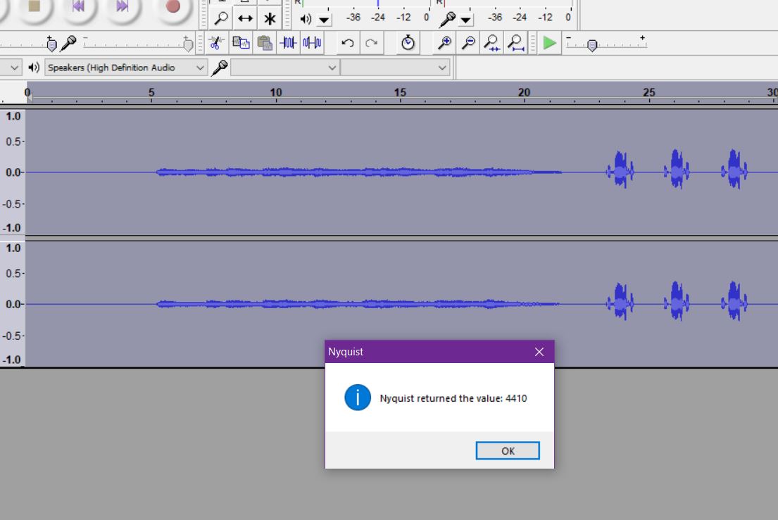

Thank you so much for giving me this code. One small issue, I don’t really know how to use it. Where can I inter or insert my threshold value? I tried it as is, and I got this message but the waveform didn’t change to square wave. What can I do?
I also tried to debug and I received this error:
error: unbound variable - TRACK
if continued: try evaluating symbol again
Function: #<FSubr-LET: #1b182d0>
Arguments:
((LO-RATE (LOWRATE TRACK STEP)) (BIGNUM (POWER 2 31)))
(SETF LO-RATE (SUM LO-RATE (- THRESHOLD)))
(SETF TRACK (FORCE-SRATE SOUND-SRATE LO-RATE))
(MULT BIGNUM (CLIP (S-MAX TRACK 0) (/ BIGNUM)))
1>
Good move trying the debug button. :ugeek:
If you are using the current version of Audacity, you either missed off the first line, or there was a space at the beginning of the first line.
The first line should be exactly:
;version 4
(with no space at the start)
In addition there was a typo in my original code that caused a different failure, but for stereo tracks only. I’ve fixed that in the previous post.
