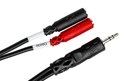

I use a field recorder and a special stereo cable and plug two lavalier microphones in to it to get separation. I record one voice on the left track and the other voice on the right track.
But I did learn that it makes the audio recording sound odd to people. It’s like sitting in the middle of a big padded room with two people talking to each other from opposite sides.
I learned to reduce the stereo track to two mono tracks, one panned all the way left and the other panned all the way right (Audacities Split Stereo To Mono does this for me) and then remixing them 70% left and 70% right sounds better to people.
