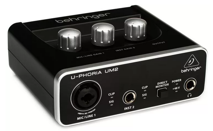

Behringer UCA-202, for one example, supports hearing yourself in perfect real time and letting you hear the backing track.
The Behringer UM2 can play you to yourself and the backing track at the same time. Quite a number of different interfaces can do this trick. It is a pretty popular need.
I’m surprised the iRig won’t do it. But that’s the end of the world. You can’t listen to the computer without the echo and the only way to get rid of the echo is ASIO and Audacity doesn’t support ASIO.
If you find settings that work, post back.
I think the Behringer UM2 has everything you need. It has XLR microphone input, +48v Phantom Power option, Line In, Separate Instrument In and it will do a headphone theatrical mixdown both directions at once. Select DIRECT MONITOR.
That’s just an example. I know it works because I tried mine.
