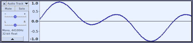

As I wrote previously, Audacity inverts in the signal processing sense only. That is, all positive samples (where the waveform is above the track’s centrer line) become negative and vice versa.
This:
becomes this:
