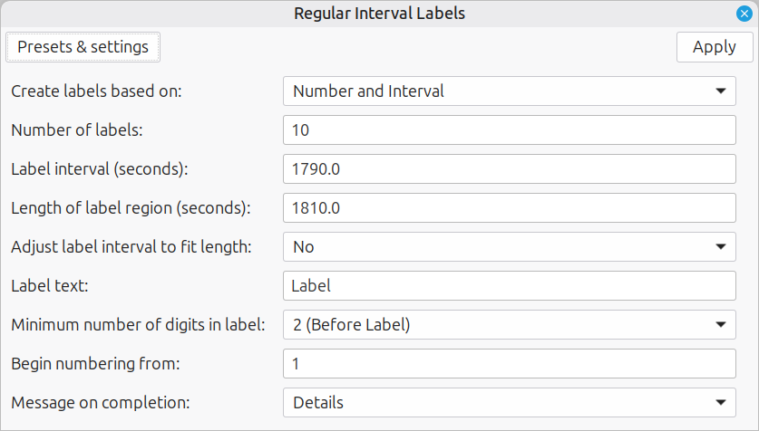

I have an audiobook (large mp3 file) that I’d like to split into 30min sections, but also have 10 seconds of overlap within each interval. So section 1 would be 0min:00sec to 30min:10sec, section 2 would be 29min50sec to 60min10sec, section 3 would be 59min50sec to 90min10sec. I understand how to use the Regular Interval Labels option to automatically split the audiofile, but can’t figure out how add in the 10 second overlaps.
Thanks
That’s 20 seconds overlap.
This produces 10 labels with 20 seconds overlap as you describe:
