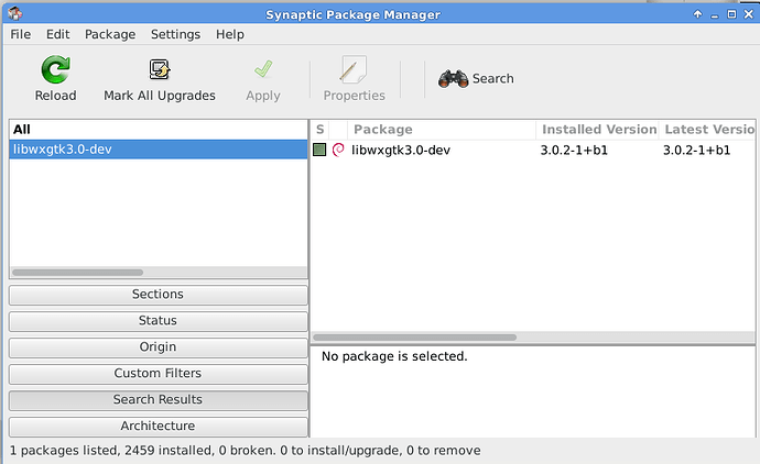

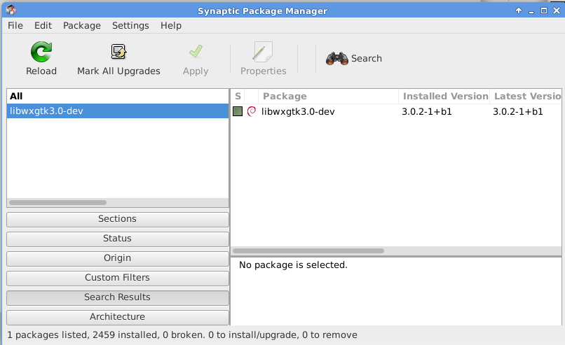

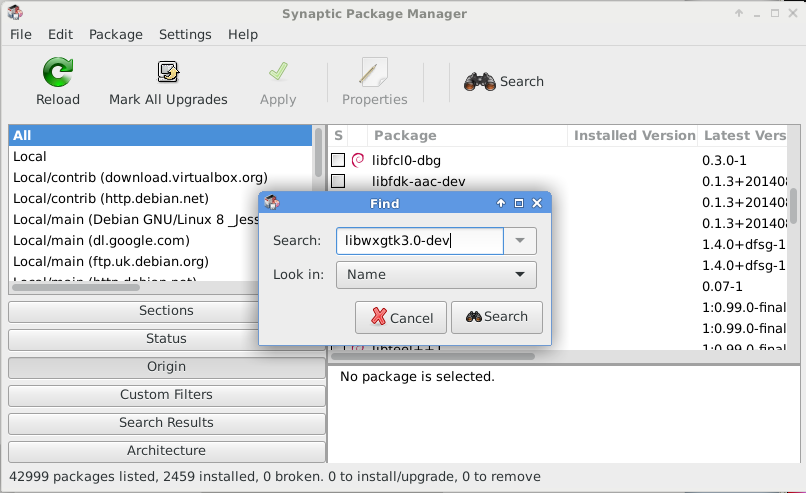

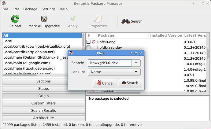

To install a package with Synaptic, if you know the exact name of the package, use the Search button and select “Name” as the type of search, and Synaptic will find the correct package (provided that the package exists in one of the repositories that your system uses.
Here you can see the Synaptic application when I search for libwxgtk3.0-dev. (This is on Debian. It’s similar on Ubuntu)
and this is the result of the search. The green square on the left indicates that libwxgtk3.0-dev is already installed.
