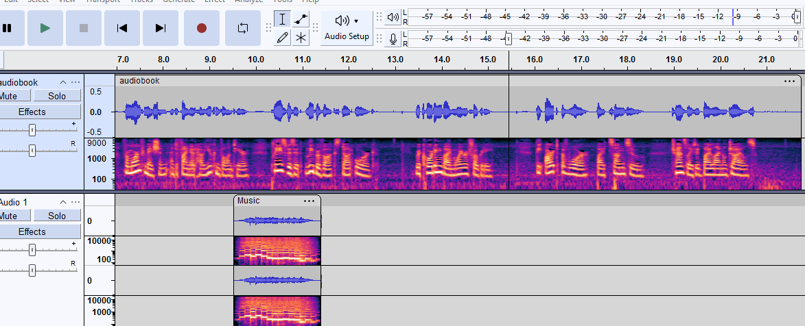

There’s more than one way to skin a cat.
This is one way: copy and paste …
skincat1
[ Audacity preferences must have “Editing a clip can move other clips” enabled]

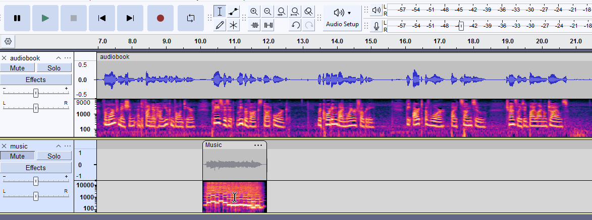

Here is another way …
skincat2
With either method paste/split at a zero crossing point to avoid clicks.
