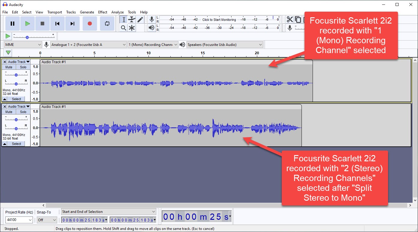

OK! I have a workaround. Though I would still like to prevent this happening if possible, rather than having to split the resulting track. Anyway…
I recorded a “mono” track using the Focusrite Scarlett 2i2 interface. As has been pointed out, however, that interface will send a stereo signal EVEN IF you only have a single mic plugged in. It’s just baked into the way the Focusrite interface works. This is no problem for the likes of Adobe Audition or Reaper. But Audacity will do a conversion if it sees a stereo signal come in AND you have “1 (Mono) Recording Channel” selected in Audacity. And that conversion cuts the input level (I think?) in half such that your recording is very low in level.
HOWEVER, if I tell Audacity to record with “2 (Stereo) Recording Channels” - EVEN IF I only want a mono file - it will recorded the full gain level on the Left channel and nothing on the right channel. After that is done, you just choose “Split Stereo To Mono” on the Audio Track dropdown, which will create a mono track out of both the left and right channels (2 mono tracks where there was one stereo track). Then you just delete the one that was the right channel and has no audio in it.
Presto! See pics:
Now I just need to know if there is a way to do this automatically? To prevent the halving of the input gain when it sees a stereo signal and you choose to record in Mono in Audacity? Or am I stuck doing this extra step every time I want to record a mono thing (like a lead vocal or voiceover/podcast, etc.) in Audacity?

In Windows “Manage Audio Devices” (Recording Tab>Properties>Advanced) I changed “2 channel, 24 bit, 44100 Hz (Studio Quality)” to 1 channel, 24 bit, 44100 Hz (Studio Quality) and BAM! Full recording level with “Mono” selected in Audacity! Woohoo!!
